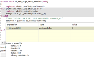

    3. But an unexpected interrupt type "ESM_G2ERR_CR5_BUSERR" occurred as below:
    4. By debuging with CCS, we find the value of register esmREG->IOFFHR turn to be "36"  and the channel of ERR Group2 turn to be "36-1-32=3" after error injection with "FLASH_ECC_TEST_MODE_2BIT".
    The question is how the register "esmREG->IOFFHR" was set with "36", and how to make it to be "54" to make channel to be ""54-1-32=21" as expected value. We must have done something wrong during the fault injection test.
    By further investigation, we found the root cause why the register "esmREG->IOFFHR" was set with "36".
    If we mark below code, the ESM interrupt of Group2 Channel3 will disappear.
    We are eager to know how to make it to be "54" to make channel to be ""54-1-32=21" as expected value.

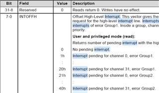

  • 4. By debuging with CCS, we find the value of register esmREG->IOFFHR turn to be "36"
    It is ESM 2.3 --> 21h + 3 = 36

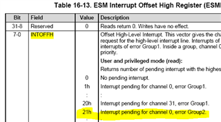

  • We are eager to know how to make it to be "54" to make channel to be ""54-1-32=21" as expected value.
    ESM 1.54 --> 41h +54-32 = 41h+22 = 87
    If esmREG->IOFFHR = 54 = 36h  --> 36h - 21h = 15h = 21 --> ESM 2.21
  • I known. You don't mention how to set esmREG->IOFFHR with "54".
    I have searched carefully in your diagnostic library source code and related API funtions, there's no register esmREG->IOFFHR related operation in sl_selftest.c at all.
    Have you tested all the APIs and verified their usability on RM57L843 device? Thanks a lot.
  •  esmREG->IOFFHR with "54".
    This register is read only, we can not set this esmREG->IOFFHR to "54" manually.
    SDL development team tested all the APIs before SDL was released. But I didn't test all the APIs.

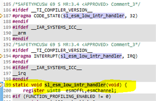

  • The ESM consists of 3 groups. The group 3 errors always generate an nERROR pin output. The group 2 errors always generate a high priority interrupt (VIM channel 0), and the group 1 errors have a configurable interrupt response (enable or disable, low priority or high priority).
    The interrupt for group 1 error is enabled using: ESMIESR1/4/7 registers, and interrupt priority is controlled by ESMILSR1/4/7 registers. You can use HALCoGen to configure the ESM interrupt:
    For fault injection option, the ESM interrupt is enabled, so interrupt is generated when an error is injected:
    The ESM interrupt handlers are defined by:

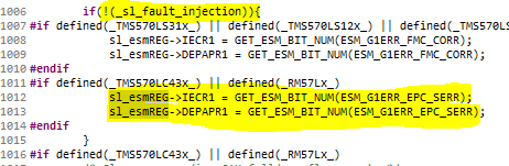

    But the SDL doesn't have fault injection option for flash 1-bit ECC selftest. SO to enable the interrupt, please comment the following statements out:
  • Hi QJ,
    1. Can you confirm if we need mark the code as below to do fault injection for RM57?
    Because if we don't mark it, any calling of SL_SelfTest_Flash will always trigger ESS2.3 fault, no matter what type the parameter is, or even if the parameter is empty.
    2. After we marked the code mentioned in step1, let us do the flash ecc 1bit error forcing test.
    According to you advice, I marked the code as below, but corresponding ESM Group1 interrupt still did not occur.
    By debugging with CCS, the key handling of fault insertion has been executed:

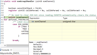

    3. After we marked the code mentioned in step1 and step2, let us do the flash ecc 2bit error forcing test.
    At the beginning, corresponding ESM Group2 interrupt still did not occur.
    But if we continue to mark the "return" line when detecting nERROR is active, the ESM Group2 interrupt was triggered.
    Why not procee with tests that trigger nERROR in the test code if nERROR is active?
    By debugging with CCS, we find the channel number is still "3" which means the fault type is "ESM_G2ERR_CR5_BUSERR".
    Can you confirm whether or not the fault shoule be "ESM_G2ERR_CR5_BUSERR", after we perform "FLASH_ECC_TEST_MODE_2BIT" fault injection?
    Isn't the interrupt type of ESM Group "ESM_G2ERR_EPC_UNCORR"?

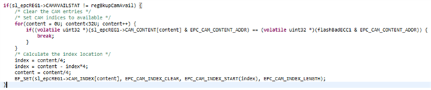

  • 1. Can you confirm if we need mark the code as below to do fault injection for RM57?
    For RM57Lx, the flash selftest should be executed from SRAM.
    There is a software bug in sl_selftest_flash() function:
    The original code is:
    The workaround:
    if(sl_epcREG1->CAMAVAILSTAT != regBkupCamAvail) {
        unsigned int counter = 0;
        for(content = 0U; content<32U; content++) {
              if((volatile uint32 )(sl_epcREG1->CAM_CONTENT[content] & EPC_CAM_CONTENT_ADDR) == (*volatile uint32 *)(flashBadECC1 &                                     EPC_CAM_CONTENT_ADDR)) {
                  break;
             counter ++;
    /* Calculate the index location */
    index = counter/4;
    index = counter - index*4;
    counter = counter/4;
    BF_SET(sl_epcREG1->CAM_INDEX[*counter*], EPC_CAM_INDEX_CLEAR, EPC_CAM_INDEX_START(index), EPC_CAM_INDEX_LENGTH);

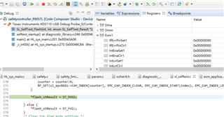

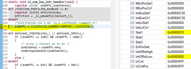

  • 2. After we marked the code mentioned in step1, let us do the flash ecc 1bit error forcing test.
    Please make sure that the bit 4 of IntEnaSet1 is set:
    I just run the test, and got the ESM interrupt:

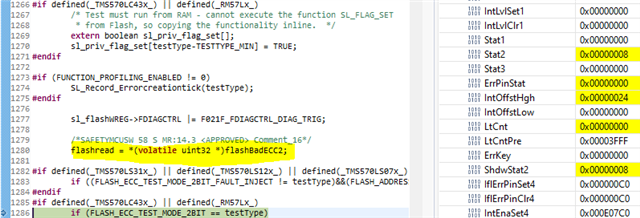

  • 3. After we marked the code mentioned in step1 and step2, let us do the flash ecc 2bit error forcing test.
    My test shows that the interrupt is generated, and nERROR becomes active (ErrPinStat=0x0):
    intOffstHigh = 0x24 --> ESM 2.3  -- Cortex-R5F Core - All fatal bus error events. [Commonly caused by improper or incomplete ECC values in Flash.]

  • 1. If we keep below handling effective, running SL_SelfTest_Flash will always trigger ESS2.3 fault no matter what the test type is, even if the function body is empty.
    It is required to run the flash self-test from SRAM rather than from flash. The purpose of this statement is to allocate a memory space for SL_Selftest_Flash() function. Please don't comment this statement out. Thanks
    2. The nERROR has been active each time before formal fault injection. So we can't proceed with the test if we don't mark it.
    Why is that? Is it activated in initial phase?
    If you run the flash selftest from flash, the ESM 2.3 may be triggered and nError is asserted. Before running flash selftest, please make sure that no ESM error flag is set, for example ESM 2.3.
    If any ECC error such as ESM2.3, please fix the error before doing the selftest.

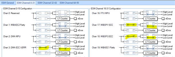

    3. Where to find and check the mapping code generated from below configuration?
    Because "FLASH_ECC_TEST_MODE_1BIT" error forcing always triggers ESM2.3 interrupt as same as "FLASH_ECC_TEST_MODE_2BIT".
    I want to check the original configuration.
    They are enabled in esmInit()

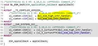

  • Hi QJ,
    1. You missed the second question listed above:
    Since "FLASH_ECC_TEST_MODE_2BIT" generates "ESM_G2ERR_CR5_BUSERR", which fault injection will generate "ESM_G2ERR_EPC_UNCORR"?
    2. "FLASH_ECC_TEST_MODE_1BIT" error forcing can generate ESM group1 interrupt "ESM_G1ERR_EPC_SERR" normallly.
    Function "sl_esm_high_intr_handler" was called after I set esmREG->ILSR1 into "1".
  • 1. "FLASH_ECC_TEST_MODE_1BIT" --> ESM 1.4 is set
    2.  "FLASH_ECC_TEST_MODE_2BIT" --> ESM 2.3 should be set. But I didn't get this bit set.
    This is expected.
