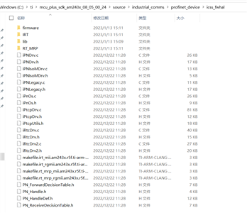

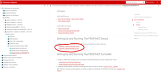

My customer is evaluating LP-Am243 on Profinet RT, and the SDK didn't contain profinet demo. Could you help on how my customer can download the Profinet demo to EVM? Thanks.

We do not have new profinet demo available in the SDK yet. It will be available in SDK 9.0 release.
