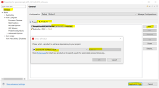

Hello forum,
we have a project with a MSP432E401Y controller and want to upgrgade the compiler version from 20.2.0 to 20.2.7 and the simplelink version from 4.10.00.13 to 4.2.00.12. Changing the compiler was not a problem in CCS. Open properties and choose the new compiler in the three sub-projects.
I thought changing the version of the simplelink would work in the same way, but ist does'nt. I can change the new Simplelink Folder and it also changee in the property windows. But when I open the properties again, then the old version is shown.
So I decided to uninstall the old version of simplelink But this does not help. Now I cannot compile the projects.
How can I change the version of simplelink?
