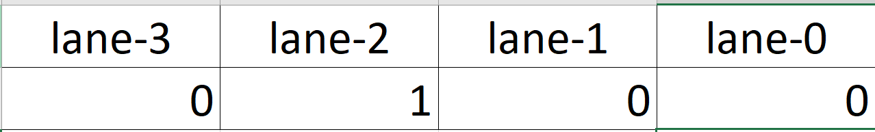

AM2732-Q1 supports four data lanes(LVDS_TXP/M), how to configure LVDS data lane number to 2 Lane(LVDS_TXP0/M0 and LVDS_TXP1/M1)?

    We use Bit masking technique is used to activate lanes.
    Bit-0 implies lane 0, bit-1 implies lane 1 and so on.
    If you want to enable lane 2 (considering you number then as lane-0, lane-1, lane-2, lane-3), the value should be:
    In your lvds configuration, you can use:
    initCfg.lvdsCfg.lvdsLaneEnable = 0x4U
