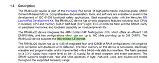

is there any difference between these two apart from temperature range, AEC-Q100 and ASIL?
Are they compatible up to 160MHz and up to 105°C?

Hi Tamas,
Yes, they are compatible up to 160Mhz and up to 105°C.

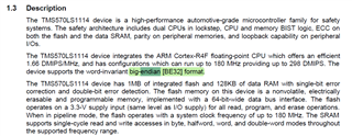

One more main difference you should consider between two devices for application implementation is "endianess".
RM44Lx20 supports little-endian[LE] format.
Where as TMS570LS1114 supports big-endian(BE) format.
Thanks & regards,
Jagadish.
Thank you for the answer. Should we consider anything else apart from recompilation with appropriate compiler setting?
No, nothing else should need to consider.
