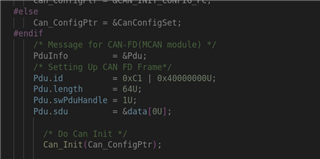

Hi Team,
We were using MCAL_AM263x_00.09.00_07 package and we were not able to find a option to disable CAN FD feature in EBtresos?
Do we need to treat this with any API?
Hi Team,
Hi Karthikeyan,
We do not have any field or check box present in the EB Tresos to enable/disable CAN FD. It should be handled through the application where the CAN ID should be manipulated to let the CAN Bus recognize the packet as FD or classic packet.
