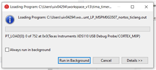

    2nd time and later flashing attempts: it is really slow during the flashing process, remaining stuck at this point for several (10-30?) seconds.
    I will always get this behavior until I reset the MCU. Then the first time flashing is almost instant, then repeats the above.
    This is similar to what I see in my proper application. However here come the differences compared to my full application. I still get an error:
    but with this timer example it has actually started debugging and I am able to step through code, put breakpoints etc. With my application it was not starting debugging and I had more errors after this one, see 1st post.

    I'm getting this simple error with not much information:
    Also Console window looks like this, no extra info:
    Playing with the length of the FLASH memory in the linker file, any value up to and including 0x8000 works, but any value above that doesn't.

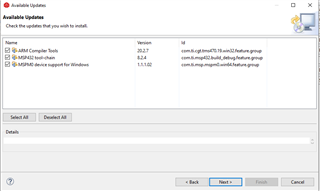

    Can you check for updates on code composer studio, there should be a new IDE patch for the MSPM0 devices. Select help -> check for updates (see below)
    For the Rev A board, make sure you are using CCS 12.3 or CCS Theia.

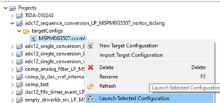

    You can also open up a debug target configuration and connect the debugger from there.  For this option go to view-> target configurations
    Then navigate to your project and right click on the .ccxml file and select launch selected target configuration.
    From here you can right click on the debug probe and connect to target. You can then load the program if you want to reflash the device.
