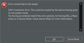

The programming doesn’t continue or end and I have to cancel it. At this point, if I exit and enter again UniFlash, I get this error when I try to connect to my MCU:
Since then, any operation I try to do with UniFlash and XDS110 I can’t restore the communication with target MCU. Of course I’ve tried to force the RESET but it still fails. This behaviour happened on three MCUs mounted on our boards.
