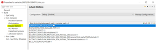

    Did you update the compiler include path and the search path for the linker for the library?

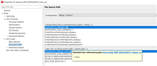

      This is what I can see. In tcpecho_MSP_EXP432E401Y_tirtos_ccs there is the dependencies for tirtos_builds_MSP_EXP432E401Y_release_ccs.
    In the linker library search path, there is the below path to tirtos_builds_MSP_EXP432E401Y_release_ccs.
    I suppose your question is after you move tirtos_builds_MSP_EXP432E401Y_release_ccs to a sub-directory such as /lib in the main project, you want to know which metadata file is changed among the various workspace metafiles so that you can put that metadata under version control. Is this the correct understanding?
