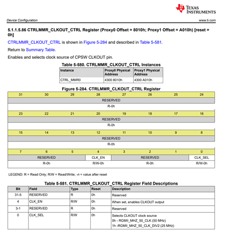

Hello Champs,
Customer wants to use AM2432 MII interface as slave EtherCAT. Can the CLKOUT0 be used for 25MHz PHY clock?
Shine
  • Hi Shine,
    Yes, the CLKOUT0 can be used for 25MHz PHY clock.
    The CLOCKOUT0 pin has a dedicated CTRLMMR_CLKOUT_CTRL register as described in the device TRM (AM243x TRM (Rev. E). Including screenshot below for reference.
    To enable 25 MHz signal, Bit0 (CLK_SEL) should be set to 1, and Bit4 (CLK_EN) should be set to 1.
