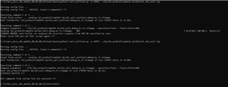

Hi
I have an LP-AM243 with CC3301 running just fine with some test code.
I have just received a new board and I was about to do all the preliminary stuff from the getting started document: cc33xx_mcu_package_R1_2/docs/html/CC33XX-mcu/getting-started-mcu.html
But the configuration stops after step 1.
In the above you can see 2 attempts
I also tried the LP-AM243 benchmark online test tool with one with the core testing and the gauges.
I can connect and flash the board
But then again a strange error occurs
Do you have any idea on what I can try to do - I have tried alot of different stuff so far.

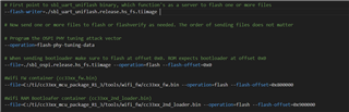

    I am trying to use the V1.3 SDK now with the secure programming folder
    This is the configuration file of my only_wifi_fw.cfg
    This is what happens when i try to run the configuration
    ALSO I have just received another LP board and that seems to be working ? So I am more and more convinced that one of the 2 new boards a bricked - what is your opinion on this ?

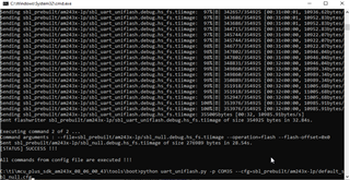

  • Hi Erik
    So I installed the 08.06 SDK and changed the default_sbl_null.cfg to use the .hs_fs. files.
    I ended up with one board working and one board that got stuck after first step.
    To me it seems like one board is defect ? or is there something I can try to do ?
    One board seems to be working - but the getting started document for the CC33xx doesn't apply for the secure boards.
    I end up being able to program the this board with the hs_fs files from the secure programming folder from the CC3301 SDK - But I am not able to enable the JTAG from CCS. So maybe the CC3301 team has an idea for this ?

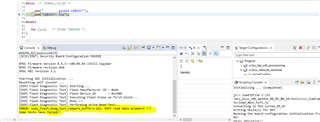

  • Hi Erik
    Thank you for your instructions and help
    I end up with this result - pointing to some sort of OSPI read data mismatch
    Kind regards
    Thomas
  • Hi Thomas,
    Thanks for your help in debugging this board.  We agree that the board is having issues.  If you want to send it in for RMA, you can do so using the link here:  https://www.mistralsolutions.com/rma-form/
