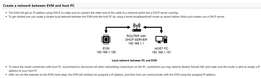

Hi team,
My customer want to create a local network using LP-Am243, and the SDK cloud says sometimes need to disable the firewall to ensure connecting. Do we have a workaround which no need to disable the firewall?
BR
Sirui

     I  Connect a ethernet cable to the AM243X-LP from host PC .If our customers use it the same way, may it be necessary to close the firewall? The article mentioned that sometimes it is necessary to disable the firewall when creating a network with a router, and did not mention Connecting a ethernet cable to the AM243X-LP from host PC. Is it possible to Connect a ethernet cable to the AM243X-LP from host PC  the firewamay also require to be closed? If that's the case, is there a way for the Ethernet program on the AM243 to avoid the firewall without the need for customers to disable 。
  • Hi
    Can you tell me are you using static ip or DHCP mode?
    If you are running some DHCP server on your PC then it is not necessary to disable firewall.
  • HI Nilabh Anand,
    I am using DHCP mode, but static IP will be enabled later ,Do I need to disable the firewall to enable static IP? How to avoid the firewall without the need for customers to disable it??
  • Hi
    I have tried it on my end but I do not see the requirement on my end to disable the firewall.
    Is customer facing some issue? If yes, please ask them to try static ip mode.

    We have the LWIP TCP server example present in SDK at: https://software-dl.ti.com/mcu-plus-sdk/esd/AM243X/latest/exports/docs/api_guide_am243x/EXAMPLES_ENET_LWIP_CPSW_TCPSERVER.html
    Please refer to example code located at  mcu_plus_sdk_am243x_08_06_00_38/examples/networking/lwip/enet_cpsw_tcpserver

  • Please modify App_setupNetif in app_main.c as follows
    static void App_setupNetif()
        ip4_addr_t ipaddr[2], netmask[2], gw[2];
        uint32_t i;
         DebugP_log("Starting lwIP, local interface IP is dhcp-enabled\r\n");
         for (uint32_t i = 0U; i < ENET_SYSCFG_NETIF_COUNT; i++)
            ip4_addr_set_zero(&gw[i]);
            ip4_addr_set_zero(&ipaddr[i]);
            ip4_addr_set_zero(&netmask[i]);
            IP4_ADDR((&gw[i]), 192,168,1,1);
            IP4_ADDR((&ipaddr[i]), 192,168,1,(i+1));
            IP4_ADDR((&netmask[i]), 255,255,255,0);
             /* Open the netif and get it populated*/
            LwipifEnetApp_netifOpen(NETIF_INST_ID0 + i, &ipaddr[i], &netmask[i], &gw[i]);
             g_pNetif[NETIF_INST_ID0 + i] = LwipifEnetApp_getNetifFromId(NETIF_INST_ID0);
             netif_set_status_callback(g_pNetif[NETIF_INST_ID0 + i], App_netifStatusChangeCb);
             netif_set_link_callback(g_pNetif[NETIF_INST_ID0 + i], App_netifLinkChangeCb);
             netif_set_up(g_pNetif[NETIF_INST_ID0 + i]);
         LwipifEnetApp_startSchedule(g_pNetif[ENET_SYSCFG_DEFAULT_NETIF_IDX]);
