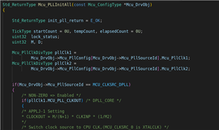

We are using MCAL_AM263x_08.06.02 and EB tresos for its configuration.
We have to configure PLL in order to achieve Core PLL to 400Mhz and PER PLL to value less than 200Mhz(Since Sys clk is 200Mhz).
But we couldn't find any container in MCU for configuring PLL.

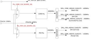

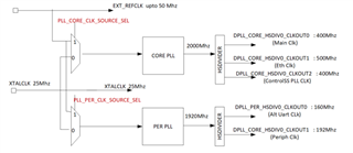

From AM2634_MicroTRM.pdf,  it is got to know that we have to select HSDIV0 values as per the below attached image.
Could you please guide us for configuring PLL?
