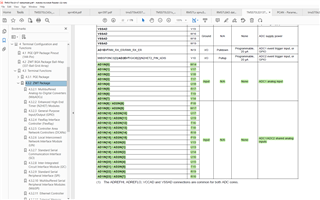

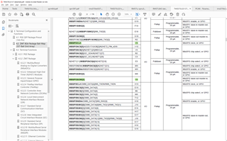

    There must be something wrong while designing that schematic, actually those are not analog pins.
    And here are the list of analog pins available in ZWT package of TMS570LS3137.
    Those pins have a single functionality only. That is,
    V8 will act as a MIBSPI3SOMI[0]
    V9 will act as a MIBSPI3CLK.
    So, you can't do any other functionality on these pins. And also remember that the analog pins will not multiplex with any digital functionality you can see the same thing on my first image.
