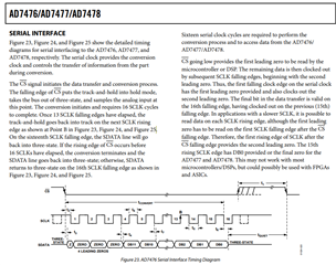

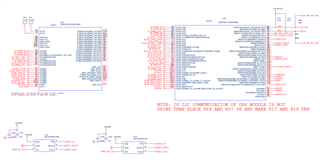

i am using this AD7476SR
TZ-R2 in schematic 3rd pin as the input voltage of 3V
from bellow code iam receiving the response is 60159 constant. changing input voltage of ADC no change in output response
