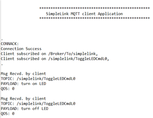

      I look up DNS for test.mosquitto.org and the IP address is 91.121.93.94. I change the SERVER_ADDRESS as follows and it works for me. On my phone, I can publish to /simplelink/ToggleLEDCmdL0 and I will see the LED turned ON on the board. This means either a URL "test.mosquitto.org" or IP "91.121.93.94" can be entered.
    //#define SERVER_ADDRESS "test.mosquitto.org"
    #define SERVER_ADDRESS "91.121.93.94"
    This is what I see on the terminal window as well as the physical LED on the board turned ON or OFF when I publish to the topic on my phone using SERVER_ADDRESS "91.121.93.94".
