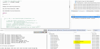

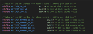

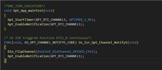

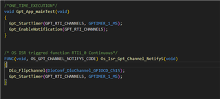

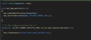

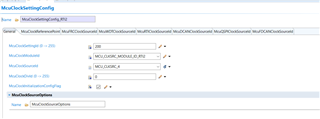

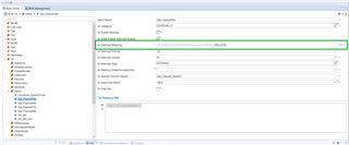

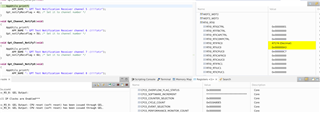

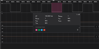

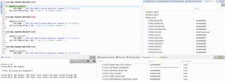

Hi Team,
I am trying to configure the GPT channel for 20µSec, 50µSec I can`t do that. whatever we configured it will allow 200µSec.
I have captured the configuration below.
I have tried with SYS_CLK and DPLL_CORE_HSDIV0_CLKOUT1. we received same result.
I have tried to feed the value to start timer mentioned below for both configurations.
Could you please correct me anything want wrong from my end and please guide us how to resolve this one. thanks.
