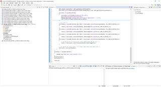

  • Thanks Ming for your reply. This is provided some insights
    As I mentioned I am developing an operating system and in my testing environment I am not using SBL so T32 scripts helps me to boot  R5F_0_0 core and I guess what I need to do in my software is to unhalt the other cores like the example sbl_qspi (The software is fleshed in other cores also by T32 scripts)
    I tried to do so but unhalt do nothing and software in other core still stuck in its entry point.
    Not sure if they already in WFI state or not.
    I have read the link: AM263x MCU+ SDK: Understanding the bootflow and bootloaders (ti.com)
    It mentions "the very first thing it does is detect the core and continue execution for Core0, while if the core is Core1 then it enters wfi loop."
    how entering  wfi loop is done in this case ? note that MSS_CTRL_R5SS0_FORCE_WFI register is global for whole R5SS0.

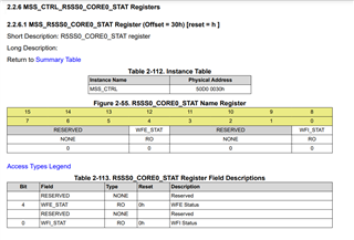

  • Also can you tell me the relation between WFI and unhalting the core, Does unhating the core means that it will get out of WFI state?
    Also I note that MSS_CTRL_R5SSx_COREx_HALT is always 0 (unhalted) for all cores no matter what (even I did not unhalt the core in the script) so do you have any idea why ?
    I am asking these question because I am designing the OS and what I need that only the master core (R5SS0_0) runs first, all other cores are in halt/waiting state and then from Master core software I trigger the other cores to run.
    But I cannot achieve this as I cannot understand the relation between halt/WFI and why the cores is always seems unhalted.

    The R5SS has three power states: Off, active, and standby. STANDBY mode refers to when there is a WFI or WFE instruction and the core hangs until there is work that wakes the core in the form of an IRQ.
    The core HALT keeps the cores from fetching instructions when they come out of reset. The main use of this is to have the cores halted until the TCMs are loaded (when booting from the TCM), though halt could be used for other purposes.
    Erik
  • Hello Erik
    Thank you for your reply and waiting your feedback regarding the sent scripts. Note that in addition to these scripts after that in master core in C code I try to unhalt other cores but nothing happens as I mentioned before.
    So could unhating be used to release the other cores from the halt state ? Because In my case nothing works in c code to release the slave cores

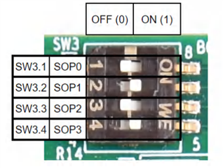

  • Hello Tareq,
    Can you try setting the bootmode to FLED mode? This is done by setting the SOP[0-3] as 0101.
    By setting the bootmode to 0101 and changing syntax, the .cmm file that you provided worked. Here is the file with the syntax that was used:

    • The CPU will enter WFI when it executes a WFI instruction
      • This is reflected in the MMR status in MSS_CTRL
      • The MMR also indicated a WFI when the HALT MMR is set. In this case this is not a true WFI since it is only set due to the HALT MMR being set.
