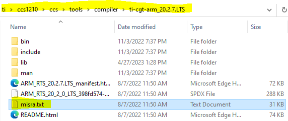

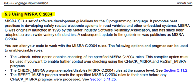

  • Hi Aaron,
    The TI ARM compiler can check for compliance to many, but not all, of the MISRA-2004 rules.  For details, please search the ARM Compiler manual for the section titled Using MISRA C 2004.
    Also see the text file named misra.txt in the TI ARM compiler installation:
