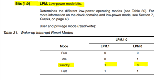

Hi Yale,
Please refer to System Module reference guide for details. https://www.ti.com/lit/pdf/spnu189.
The register to use is CLKCNTL.
