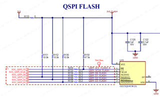

AM2732-Q1: QSPI D1 need pull up or not
Part Number: AM2732-Q1
Other Parts Discussed in Thread: AM2732
InTIDA-020047 Two-device mmWave cascade reference design,QSPI D1 pull up with 10kohm resister externally,which is pull down internally in AM2732, is there a conflict with pull up and down simultaneously.
In a case of QSPI flash not be mounted,the pull up circuit will generate sink current from pull up source that may cause AM2732 startup failure.
TIDA-020047 Schematic
