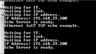

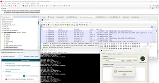

I am working on validation of PHY interface with microcontroller using enet_tcpecho_server example code with launchpad.
I am able to get IP address through tera term but flailed in socket test, also not able to connect target using ROV.
Also not getting IP address on Wireshark as mentioned in output of tera term.
Below image for your reference.
Please share your feedback to validate this code on launchpad.

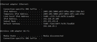

  • Your screenshot is a bit different from last time where you showed 16.254.35.17.  With 192.168.2.119, should be fine. Check if your PC and MCU are on the same subnet. Are they connected to a switch?
  • Hi Charles,
    >> Both are in same subnet.
    >> Yes
    We are getting traffic from PC rather than EV Board.
    We also checked on Advanced port scanner for open port status. It was showing that there is no open port.
    Please share your feedbacks.
    Kiranjit

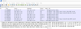

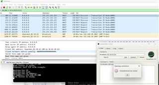

  • Hi Charles,
    Please check the wireshark traffic for the TI launchpad before and after request from socket test utility.
    Kiranjit
      Your wireshark seems to show that you have the DHCP address acquired. Can you provide the terminal window output? See below. I just run the same example and I don't see an issue. After DHCP address is acquired, it is displayed on the terminal window. I then type that IP address on SocketTest. It immediately connects to the server. The client sends a test message 'This is just a test'. The server echoes back the same but invert the letter case.
    This is my wireshark capture. If you look at frame 147, the message 'This is just a test' is sent by the client 192.168.254.79 (my PC) to 192.168.254.200 (my LaunchPad).
      Can you run enet_lwip and capture the wireshark and the terminal window output? enet_lwip does not rely on SocketTest. This is to make sure it is not some issue related to your SocketTest. As I mentioned, if you fail to run enet_lwip successfully, it is your network problem and I don't know how to solve it. I already suggested you try out other network to determine if it is a office network problem. It is up to you.

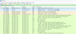

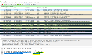

  • Hi Charles,
    Thanks for your response!!
    I will try your suggested steps once I reach office.
    Below are some screenshots of Wireshark and terminal window which I tried on my Home WIFI network.
    As it is running perfectly on your side so please share your comments and feedbacks to resolve this network related issue.

  • Hi Charles,
    It's up and running now. Maybe there was some network issue in the office.
    Wireshark capture for enet_lwip example
    Wireshark capture for enet_tcpecho_server example
