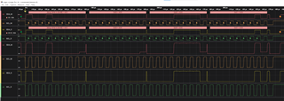

    FYI, I have added a PCA9517A I2C buffer between the AM2434 I2C0 and the AD9542 as we understand that the I2C edges from the AM are non-compliant with I2C ('too fast'). Below is a typical I2C transaction trace (either side of PCA9517A) of both analog and digital signal integrity.
    Thanks, Steve

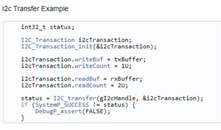

    Oh, I based my code on the SDK documentation:
    However, I have now refactored it and will retry:

    The refactored code ran overnight (with about 30-40 transactions per second). Although not conclusive, this is the longest it has run without timing-out by an order of magnitude so this is very encouraging.
    However, I only did it this way as this is 'what the SDK told me to do'. Please kindly amend as required.
