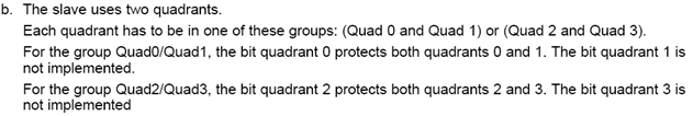

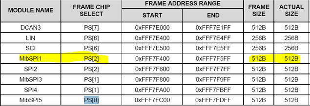

  • The PSPWRDWNSET0 register controls PS0-PS7. So the PS[0] is controlled by the lower 4 bits of the PSPWRDWNSET0[3:0] while the PS[2] is controlled  by PSPWRDWNSET0[11:8]. Each PS is controlled by 4 bits.
    MibSPI1 -- PS[2] -- PSPWRDWNSET0[10] should be set, bit 11 is not set.
  • Hi QJWang!!
    Let me see if I understand. I think there's a little mistake in your answer but it made me realize the possible solution.
    So MibSPI1 is between 0xFFF7F400 and 0xFFF7F5FF (512B) and SPI2 is right after, between 0xFFF7F600 and 0xFFF7FFF (again 512B). Both belong to PS[2] (PSPWRDWNSET0[11:8]), but because MibSPI1 comes first, MibSPI1 is controlled by bits 8 and 9, and SPI2 by bits 10 and 11. (this is the little mistake I think). If I'm correct, then the application report is also correct in the example disabling MibSPI1.
    So bits 8 and 9 have to be set, but thanks to that image you posted in your answer, I know that only the first bit (bit 8) will respond and effectively get set, am I correct?
    That would be why if I try to set the entire register, only bit 8 responds for this peripheral. The same would apply to the rest of peripherals, maybe also only 1 responds for each peripheral. As a reminder, here is what the read of the entire register PSPWRDWNSET0 looks like after trying to set all 32 bits:
    01010000000100010000000100000101b
    Let me know if you agree with me in this reasoning.
    Thanks a lot!
  • Yes, The MibSPI1 -- PSPWRDWNSET0[9:8] = [0, 1]
    your understanding is correct.
    The unimplemented bit  for example bit 9 is not set.
