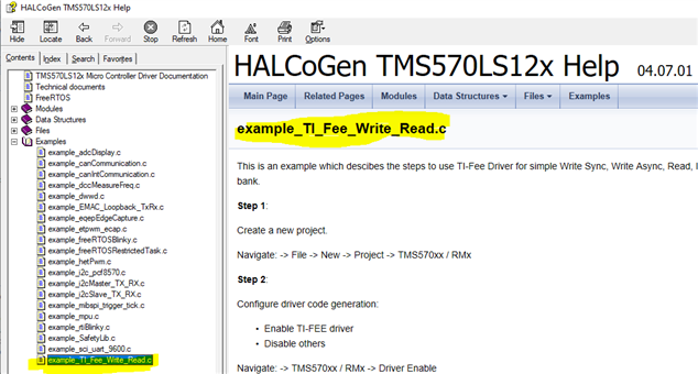

  • 3) The customer want to use bank7 to store data and want to modify data in bytes, how to implement it?
    You can use FEE driver to do this.
    Please use the FEE example in HALCOGen as the starting point.
