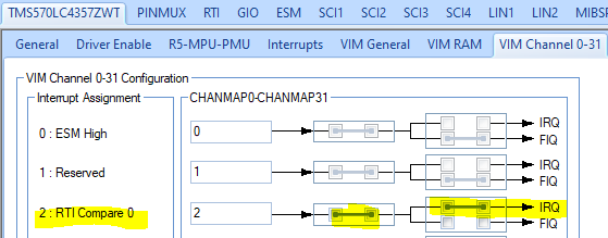

Hello E2E Experts,
Good day.
Is it possible to blink user-led in TMS570LC43x with a delay of one second using HET?
If possible, share the firmware also.

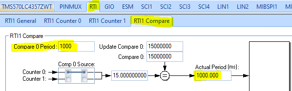

Hi CSC,
You can enable RTI interrupt and turn/off LED in the RTI ISR.
