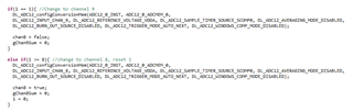

  • Hi Amruta,
    You can use the single conversion mode but, you would need to call a couple of functions inside of your code.
    1. You will need to configure the conversion memory(s) this can be done with the DL_ADC12_configConversionMem function.
    2. Enable the memory address interrupts with the DL_ADC12_enableInterrupt function
    3. You need to change the start address for the ADC readings with DL_ADC12_setStartAddress before you do a conversion so the ADC will do a single conversion on that memory address.
    If you only want 1 channel sampled at a time it might be easier to just change the Conversion Memory0 then proceed as normal. I've done this before and below is how I alternated sampling 2 different channels.

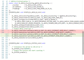

  • Hi Luke,
    Thank you for your reply. I tried by selecting MEM0 for 3 different channels, it's working.
    I tried to select MEM1 in existing sample program of single conversion, but it's not working for MEM1.
    below settings i had done,
    while (1) {
    DL_ADC12_startConversion(ADC12_0_INST);
    while (false == gCheckADC) {
    __WFE();
    adcResult = DL_ADC12_getMemResult(ADC12_0_INST, DL_ADC12_MEM_IDX_1);
    if (adcResult > 0x7ff) {
    DL_GPIO_setPins(GPIO_LEDS_PORT, GPIO_LEDS_USER_LED_1_PIN);
    } else {
    DL_GPIO_clearPins(GPIO_LEDS_PORT, GPIO_LEDS_USER_LED_1_PIN);
    gCheckADC = false;
    DL_ADC12_enableConversions(ADC12_0_INST);
    void ADC12_0_INST_IRQHandler(void)
    switch (DL_ADC12_getPendingInterrupt(ADC12_0_INST)) {
    case DL_ADC12_IIDX_MEM1_RESULT_LOADED:
    gCheckADC = true;
    break;
    default:
    break;
    SYSCONFIG_WEAK void SYSCFG_DL_ADC12_0_init(void)
    DL_ADC12_setClockConfig(ADC12_0_INST, (DL_ADC12_ClockConfig *) &gADC12_0ClockConfig);
    DL_ADC12_setStartAddress(ADC12_0_INST,1);
    DL_ADC12_configConversionMem(ADC12_0_INST, ADC12_0_ADCMEM_1,
    DL_ADC12_INPUT_CHAN_2, DL_ADC12_REFERENCE_VOLTAGE_VDDA, DL_ADC12_SAMPLE_TIMER_SOURCE_SCOMP0, DL_ADC12_AVERAGING_MODE_DISABLED,
    DL_ADC12_BURN_OUT_SOURCE_DISABLED, DL_ADC12_TRIGGER_MODE_AUTO_NEXT, DL_ADC12_WINDOWS_COMP_MODE_DISABLED);
    DL_ADC12_setPowerDownMode(ADC12_0_INST,DL_ADC12_POWER_DOWN_MODE_MANUAL);
    DL_ADC12_setSampleTime0(ADC12_0_INST,500);
    /* Enable ADC12 interrupt */
    DL_ADC12_clearInterruptStatus(ADC12_0_INST,(DL_ADC12_INTERRUPT_MEM1_RESULT_LOADED));
    DL_ADC12_enableInterrupt(ADC12_0_INST,(DL_ADC12_INTERRUPT_MEM1_RESULT_LOADED));
    Thanks, and regards,
    Amruta
