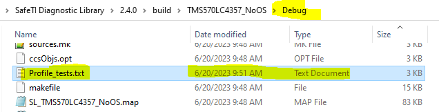

  • Q4. where we can get/store the data  of below code?
    The profiling of the functions is not enabled by default. Is it enabled in your project? Did you check the Debug folder?
  • Hi Wang,
    I have already enabled the "FUNCTION_PROFILING_ENABLED" macro.
    But i did not find any "Profile_tests.txt" file inside the debug folder.

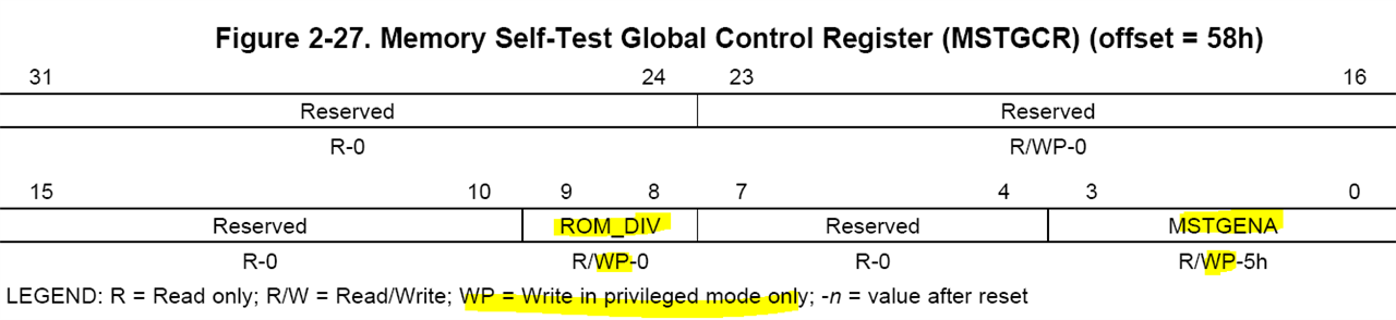

    I have an one queries that:-
    inside the  void afterSTC(void) function. If i am getting any of one "RAMTYPE_MIBSPI2_RAM" failure.
    /* Initialise MIBSPI SRAM */
    SL_Init_Memory(RAMTYPE_MIBSPI1_RAM);
    SL_Init_Memory(RAMTYPE_MIBSPI2_RAM);
    SL_Init_Memory(RAMTYPE_MIBSPI3_RAM);
    SL_Init_Memory(RAMTYPE_MIBSPI4_RAM);
    SL_Init_Memory(RAMTYPE_MIBSPI5_RAM);
    and If the status bit of  MSTDONE is not set than how we will solve this problem.
    We want to re run this test case again. what we have to do?
    If you having any document regarding error solving of particular test failure please let us know. it will be very helpful for us.
    Thanks and regard
    Pankaj Verma
  • We want to re run this test case again. what we have to do?
    The auto-init can be disabled by writing 0x5 to MINITGCR register, then re-enabled (writing 0xA to MINITGCR).
    I will check this
  • But i did not find any "Profile_tests.txt" file inside the debug folder.
    It is located in debug folder.
    The code will be looped at:
             __asm(" b #-8 ");
    to reach to fptests =  fopen("Profile_tests.txt","w+"); please suspend the ececution at __asm(" b #-8), and point to line fptests = fopen(...) and click "Move to line"

  • Some diagnostic tests in SDL can not be run in user mode.

  • 1. which test cases we need to run in supervisor mode (0x13) and which we can run system mode (0x1F)? any document available please let me know?
    If the selftest API needs to write WP bit field, you have to switch MCU to privilege mode (non-user mode) before calling this API.
    for example:
  • 2. where we can change the mode from supervisor mode (0x13) to system mode (0x1F)? so we can initialize RTOS scheduler properly. otherwise code will never activate scheduler? please support.
    FreeRTOS tasks can be created to run in either Privileged mode or Unprivileged mode. A privileged task has access to the entire memory map, can be created using either the xTaskCreate() or xTaskCreateRestricted() API function. An unprivileged task only has access to its stack, and can only be created using the xTaskCreateRestricted() API.
    A Privileged mode task can call portSWITCH_TO_USER_MODE() to set itself into Unprivileged mode. A task that is running in Unprivileged mode cannot set itself into Privileged mode.
    Both supervisor mode (0x13) to system mode (0x1F) are privileged mode.
