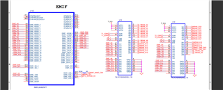

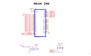

Hi, I have few doubts about EMIF Interface.
If only one memory is connected to RM57L843 or can I use all  memory interface successively.
If yes means I am connecting a RTC NVRAM, MRAM and NAND Flash memory to controller so all three memory shares the data lines, WE, OE and address line(expect NAND flash memory) only the chip enable is different.
So here my doubt is if I write a byte of data to MRAM the same data is also send to another memory because of shared lines. Yes here the chip enable is different but all memory draws current from controller or not? or If any other booster is connected between controller and memory is correct or not?
If I connect any other booster. For example if I connect 74LVC16245ADGG_118 in between, is this affect speed of operation of EMIF or not?
