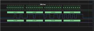

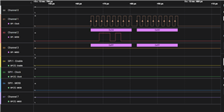

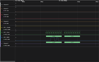

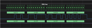

Am working on MCAL v8.6.2 for the micro AM263, I have configured SPI0 and SPI1 as CAT2 ISR.
Data width is configured as 8bit for both the channels. attached the snap for your reference.
For SPI0 am getting 8bit as it is configured
But am getting the 9bit in the logic analyzer for the SPI1.
Could you please let me know where I did the mistake?

  • Hi Rubina,
    Can you clarify on below questions?
    1. In the configuration attached, SPI0 instance configured in loopback mode and SPI1 instance not configured in loopback mode. Is this expected?
    2. In the snaps you attached, can you explain what is 0xFF, 0x12, 0x1FF?? Sorry I did understand clearly.
    Thanks And Regards,
    Sunil Kumar M S
  • Hi Sunil,
    1. There is no expectation for configuration. From where I have configured SPI1 in loopback mode
    2. In this snapshot
    12 was a MOSI data.
    FF and 1FF was a data from MISO.
  • Hi Rubina,

  • Hi Rubina,
    Can you please share both MOSI and MISO waveforms of SPI0 and SPI1? Please don't enable Logic analyzer to analyze SPI data? I want to check without that.
    Thanks And Regards,
    Sunil Kumar M S
  • Hi Rubina,
    Any updates here?
    Thanks And Regards,
    Sunil Kumar M S
  • Hi Sunil,
    Please find the SPI 1 waveforms for MISO and  MOSI
    Please find the waveforms of SPI 0 MISO and MOSI
  • Hi Rubina,
    Thank you for sharing the waveforms. If I review SPI1 configuration, you have enabled start bit. So start bit will be added before the MSB to indicate
    whether the next MCSPI word must be handled as a command or as data. Please refer section "MCSPI Protocol and Data Format" in TRM for more details.
    Thanks And Regards,
    Sunil Kumar M S
