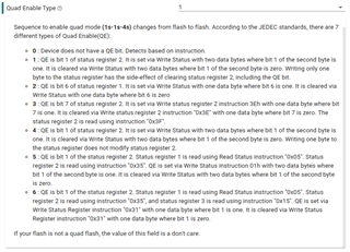

    *There's one strange part, so I'll share it.
    It is marked as "enableType": "7" for p114 inside the JSON.
    However, Quad Enable Type in sysconfig is only defined from 0 to 6.
    Best regards

    I checked the operation by manually entering the flash module information of the "sbl_uart_uniflash_am263x-cc_r5fss0-0_nortos_ti-arm-clang" project.
    However, "Quad Enable Type" is set to 1, but please check if this is correct. ("enableType": "7" for p114 in JSON)

    Also we have tested the driver with GD25B64 device from Gigabit but not with the device "GD25F128F" but if the device follows the standard JEDEC xSPI requirements it should be supportable. If you have the datasheet for the flash, feel free to share the same. I can help you out with QE bit settings. Before trying QE bit you can check if 1-1-1 is working for Standard Read and Fast Read.
    Just for the information, QE bit details are very well explained in the syscfg -
    Hope this helps.
    Aakash
  • Hi ,
    I checked the datasheet shared by SungIL Park. The QE bit settings in syscfg should be 1 i.e. Register 2 bit 1
    Hope this helps.
