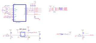

HI, I am using RM57L843 Microcontroller,
The problem is when I power on the controller it goes reset and doesn't came out.

Hi Veerappan,

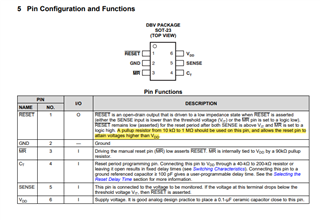

The only thing i am suspecting in your schematic is that pull-up resistor on RESET signal
According to the manual it should be in between 10k and 1M but in your schematic i can see it is 1k ohm.
So, i would suggest you change this resistor value and see the result.
