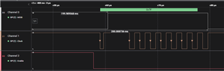

    I have configured SPI as you suggested using sysconfig. I selected the use case as custom and used only POCI, PICO and CLK pins. However, when I manually make the CS pin low, there's an initial clock pulse that makes the data read erroneous. This pulse is also present in 4 pin mode, but in that mode the CS pin is pulled low only after that initial pulse is over. How can I stop this from happening?

    Can you explain your system setup a little bit more? You are use the AM243x SPI as the master or slave?
    What do you mean by "I selected the use case as custom and used only POCI, PICO and CLK pins"? Can you send your sysconfig for SPI?
