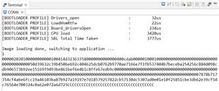

I replicated the situation with a project and in LaunchPad, the project is attached here: qspi_flash_dma_transfer_am263x-lp_r5fss0-0_nortos_ti-arm-clang.zip
From the serial terminal, you can see that the device now will not boot again:
Please give your further suggestions about this issue.

    the WSON package for the flash used in both LP and CC platforms of AM263x do not have the reset pin needed to avoid this problem, in this case, the flash reset is tied high internally like the datasheet mentions. Like Aakash suggested before, you would want to tie the reset of the flash to the reset signal of the SoC so that the resets are synchronized and the flash is not left in a partially/incorrectly configured state.
    What is most likely happening is that the flash is getting caught in a busy state due to SoC keeping the Flash active (CSN LOW) with no data being sent while it's issuing a reset; in this state, the controller releases the QSPI lines but the flash remains on and active while this happens. According to the flash datasheet this is a spec violation, and it would explain why the only way of getting it back to operate is by power cycling the flash device.
    Without a reset pin, I don't believe there are any workarounds to this issue other than power cycling the flash device to make it reach standby mode again. Typically, interrupting the flash memory mid-operation without proper use of the HOLD or RESET functionalities can result in errors like the flash getting stuck.
