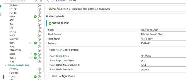

     My customer would like  read/write Flash in application. They did a simple test by using  gpio_led_blink_am243x-lp_r5fss0-0_nortos_ti-arm-clang in SDK8.6.
1. import demo project gpio_led_blink_am243x-lp_r5fss0-0_nortos_ti-arm-clang
2. Add Flash support in syscfg. use default setup for FLASH and OSPI.
3. Add FLASH access codes in gpio_led_blink.c basically it merge some code in ospi_flash_io demo codes.

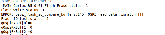

But after program executes, they always get erase error return from  status = Flash_eraseBlk(gFlashHandle[CONFIG_FLASH0], blk);
They have some questions:
1. Anything missing so flash block erase fail? Why they can't erase and write to Flash in user application?

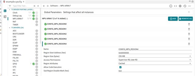

2. Do they need to turn on firewall/MPU or something else before they use Flash?
3. Can they use sector erase instead of block ease before they write data? (Sector Erase also fail in the test)
