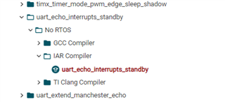

For other IAR examples, you can find them at this location:
Arm®-based microcontrollers/Embedded software/MSPM0 SDK - 1.00.01.03/Examples/ Development Tools/LP-MSPM0L1306/ DriverLib/”NAME_OF_EXAMPLE_CODE”/No RTOS/IAR Compiler/”NAME_OF_EXAMPLE_CODE”

Hi Alexei,
We currently only have certain projects with IAR. Ex: uart_tx_multibyte_fifo_dma_interrupts
Also, There are more examples outside of the DriberLib directory.

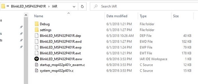

Can you point me in right direction?
What i need is simple IAR project, like you have for any other MCUs:
THank you.

Hi Alexei,
If you mean to get an IAR GPIO toggling program for an MSPM0 MCU (specifically an MSPM0L1306 MCU), here's the location for it:
Arm®-based microcontrollers/Embedded software/MSPM0 SDK - 1.00.01.03/Examples/ Development Tools/LP-MSPM0L1306/ DriverLib/gpio_toggle_output/No RTOS/IAR Compiler/gpio_toggle_output

Hi Diego,
What I am asking for is complete IAR project.
does not matter how simple it is.
What you are referring is the set of files needed to be included in IAR project.
And as far as I know MST430 is completely different family of 16 Bit MCUs.

Hi Alexei,
You can download the SDK for the MSPM0L306 product page from the MSPM0L306 product page where you can find and import examples containing complete projects with the option to compile them using IAR.
