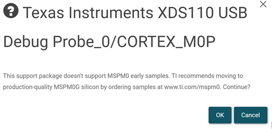

My customer is wanting to move from pre-production silicon to final silicon samples. They updated to the latest SDK, but still see errors like this.
Is there a support package add-on that can be used to bypass this restriction?

Hi Ryan,
If the customer has PG2 samples, they should download the SDK which is now posted on the web. There are no support packages needed. After installing the latest SDK and restarting CCS, they should check their project settings and switch from the previous SDK version to the latest one.
From the top CCS menu select Window>Preferences then look to see if the MSPM0 SDK 1.0.1.03 shows up in the list of discover products.
