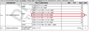

  • Which pin you are using? Only HSIO can output the 32MHz clock.

    For MSPM0L1105TDYY, the only pinout with CLK_OUT is PA22 which is SDIO, not HSIO. For MSPM0G3507SRHB, PA7, PA14 and PA22 are tested where PA14 is HSIO. But I don't think SDIO is an issue since SDIO should be able to run up to 32MHz with 3.3V VDD. In fact, I also tried different division ratio, all have the same issue.
