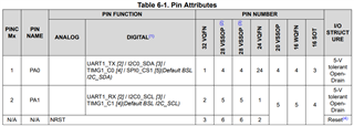

I have a question about I2C bootloader.
NRST pin is muxed with PA1 for 16-pin SOT package.
PA1 is required to use the BSL for I2C.
NRST pin must be pulled up to VDD and TI recommends connecting an external 47-kΩ pullup resistor with a 10-nF pulldown capacitor.
But PA1 is connected pull-up resistor to VDD.
How should the NRST and SCL pins be configured to use I2C BSL for users who choose 16 pins?
