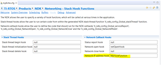

      In NDK you can add hook function, perhaps you can add your hook callback function for 'Network IP address hook'. See below example.
    Or you can add to the .cfg file manually like below.
    Global.networkIPAddrHook = "&MyHookFunction";
