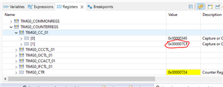

My problem is that the timer does not measure the period time correctly. The value I get for the variable "pwmPeriod" is always 1751(dec), no matter what frequency is applied to pin 1.
1751*(1/15630) = 11ms/period -> should be 2.36ms/period.
The value of register CC01 is always 0xF9.
The value of register CC00 is changing, depending on the high-time of the signal.
Does anyone know what I am doing wrong?
