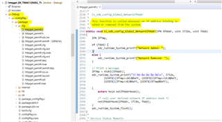

Hi
I am using TM4C129ENCPDTI in CCS Version 12.2.0, TI-RTOS for TivaC 2.16.01.14, XDCtools v 3.32.0.06_core and Compiler ti-cgt-arm_20.2.7.LTS and wolfssl-3.9.10-stable.
I try to communicate the  TM4C1290NCPDT  to server .We have connected board to router and got IP address and sending data to a server. after some time the network connectivity is lost  and that time I need to do other tasks, How to check the network connectivity is lost ?
I using httpsget example, once IP address is assigned that time the console is print the "network Added" and if the Ethernet link becomes down, it does not print to "Network Removed".
      I'm not an expert in this area but the 'Network Added' or 'Network Removed' code is implemented in the generated NDK code. See httpget_pem4f.c file. According to the comment, the 'Network Remove' is printed when the IP address binding is removed from the system.
    Without sufficient knowledge of NDK, I'm not aware of a NDK API to interrogate the link status of PHY. I think you may need to manually check if PHY link is up or not by reading the PHY status register. See below snippet of code for a non-TI-RTOS Ethernet example based on lwIP stack. the lwIPLinkDetect is periodically called in a lwIP timer.
    // This function performs a periodic check of the link status and responds
    // appropriately if it has changed.
    #if LWIP_AUTOIP || LWIP_DHCP
    static void
    lwIPLinkDetect(void)
    bool bHaveLink;
    struct ip_addr ip_addr;
    struct ip_addr net_mask;
    struct ip_addr gw_addr;
    // See if there is an active link.
    bHaveLink = MAP_EMACPHYRead(EMAC0_BASE, PHY_PHYS_ADDR, EPHY_BMSR) &
    EPHY_BMSR_LINKSTAT;
    // Return without doing anything else if the link state hasn't changed.
    if(bHaveLink == g_bLinkActive)
    return;
    static void
        bool bHaveLink;
                                    EPHY_BMSR_LINKSTAT;
            return;
        // Save the new link state.
        g_bLinkActive = bHaveLink;
        // Clear any address information from the network interface.
        ip_addr.addr = 0;
        net_mask.addr = 0;
        gw_addr.addr = 0;
        netif_set_addr(&g_sNetIF, &ip_addr, &net_mask, &gw_addr);
        // See if there is a link now.
        if(bHaveLink)
            // Start DHCP, if enabled.
    #if LWIP_DHCP
            if(g_ui32IPMode == IPADDR_USE_DHCP)
                dhcp_start(&g_sNetIF);
    #endif
            // Start AutoIP, if enabled and DHCP is not.
    #if LWIP_AUTOIP
            if(g_ui32IPMode == IPADDR_USE_AUTOIP)
                autoip_start(&g_sNetIF);
    #endif
        else
            // Stop DHCP, if enabled.
    #if LWIP_DHCP
                dhcp_stop(&g_sNetIF);
    #endif
            // Stop AutoIP, if enabled and DHCP is not.
    #if LWIP_AUTOIP
                autoip_stop(&g_sNetIF);
    #endif
