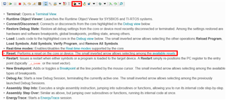

After using "SOC_gateEpwmClock" to disable EPWM instance, I am not able to reload the code using   button in CCS. I mean after reloading the MCU does not boot up And I need to turn the power off/on to be able to reload again.
Should I ungate the epwmclock in GEL file? or Is there anything that I should do in GEL file?
