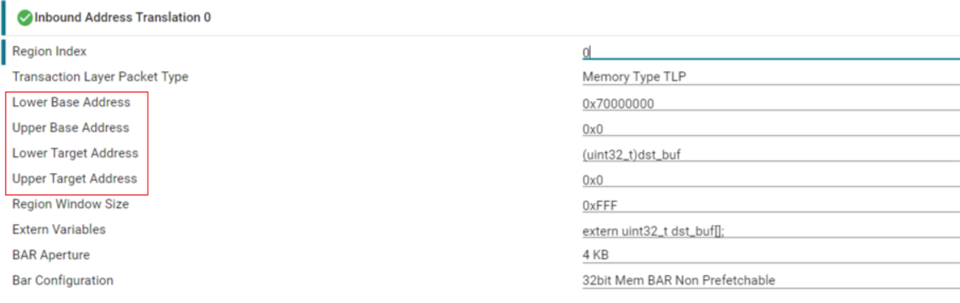

Are they PCIE bus addresses,the Base Address of inboundand and Target Address of outbound ?
How should these addresses be determined? Do you have relevant documents?

For an Ep device of inbound , I don't know how to configure these specific addresses, what is the base address, what is the target address?
What specific steps should I follow if I want to change these addresses?

In the pcie_buf_transfer_ep_am243x-evm_r5fss0-0_nortos_ti-arm-clang demo, what is the address 0x70000000 in syscfg? Is it PCIe address?

Sorry for the delay in the response. Digging further on your question, the address space 0x70000000 is corresponding to MSRAM_256K0_RAM in the Table 2-1 of TRM. My understanding is that the ATU space is mapped to this RAM in the PCIe example you pointed out. I believe this address can vary based on the implementation of the software. Please let me know if this answers your question.
