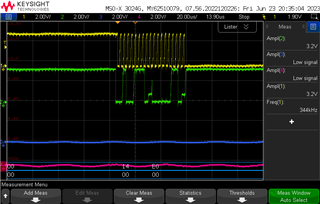

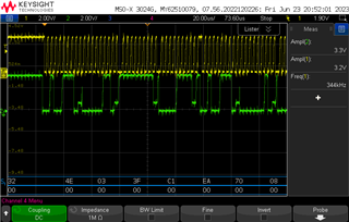

    Please see the scope captures below for both TI-RTOS (1st code) and Tivaware functions(2nd code) on our custom board.
    TI-RTOS function(I2C)
    Tivaware function (I2C)
    Since TI-RTOS code works on the reference board, you should attach the scope capture for the reference board vs custom board with both running TI-RTOS.
    I will also assume the TivaWare function will work on the reference board, correct?

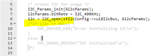

    I see in your below code, you comment out lines 9-14. How can you guarantee you have acquired the handle when you call I2C_open(). If i2c is NULL then you haven't gotten the handle yet. Without the handle, how can you guarantee I2C_transfer() will work?
    Looking at your waveform, it looks like it is sending a address byte for write direction and a data byte and it then stops. If you want to write/read a register, you need to make sure your command adheres to the expected command sequence described in the slave device datasheet.
    What is your vui8writeCount, vui8readCount? If you want to read one register then I think you need to set vui8writeCount to 1 and vui8readCount to 1. See the above i2c command sequence where it is slave_addr(W)->Register_addr->slave_addr(R)->Data.
    I will suggest you start with 100k speed rather than 400k. Once you get everything working, you can change back to 400k.
    --Even after uncommenting the above lines (of checking if I2C is NULL),the transfer isn't being carried out successfully. The code reaches the I2C_transfer() function but doesn't reach the next line.

    What is the pullup resistor value you use? In your custom board you have ACK bit (see below) that may be misinterpreted as NACK by the master. Can you look at the I2C registers and if you are getting any errors?

    I will share the scope captures on reference board as well as 100k on custom board once I check them.
