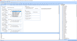

Could you provide an example on how configure all peripheral frames as "strongly ordered" memory (STRONGLYORDERED_SHAREABLE) ?
Halcogen comes with pre-set values for peripherals (like NORMAL_OINC_NONSHARED) .
Following is the MPU region configuration we use.
Thanks in advance for you response.
Marcio
DRIVER.SYSTEM.VAR.CORE_MPU_REGION_1_BASE_ADDRESS.VALUE=0x00000000
DRIVER.SYSTEM.VAR.CORE_MPU_REGION_1_ENABLE.VALUE=1
DRIVER.SYSTEM.VAR.CORE_MPU_REGION_1_END_ADDRESS.VALUE=0xffffffff
DRIVER.SYSTEM.VAR.CORE_MPU_REGION_1_PERMISSION.VALUE=PRIV_NA_USER_NA_NOEXEC
DRIVER.SYSTEM.VAR.CORE_MPU_REGION_1_PERMISSION_VALUE.VALUE=0x1000
DRIVER.SYSTEM.VAR.CORE_MPU_REGION_1_SIZE.VALUE=4_GB
DRIVER.SYSTEM.VAR.CORE_MPU_REGION_1_SIZE_VALUE.VALUE=0x1F
DRIVER.SYSTEM.VAR.CORE_MPU_REGION_1_SUB_0_DISABLE.VALUE=1
DRIVER.SYSTEM.VAR.CORE_MPU_REGION_1_SUB_1_DISABLE.VALUE=1
DRIVER.SYSTEM.VAR.CORE_MPU_REGION_1_SUB_2_DISABLE.VALUE=1
DRIVER.SYSTEM.VAR.CORE_MPU_REGION_1_SUB_3_DISABLE.VALUE=1
DRIVER.SYSTEM.VAR.CORE_MPU_REGION_1_SUB_4_DISABLE.VALUE=1
DRIVER.SYSTEM.VAR.CORE_MPU_REGION_1_SUB_5_DISABLE.VALUE=1
DRIVER.SYSTEM.VAR.CORE_MPU_REGION_1_SUB_6_DISABLE.VALUE=1
DRIVER.SYSTEM.VAR.CORE_MPU_REGION_1_SUB_7_DISABLE.VALUE=1
DRIVER.SYSTEM.VAR.CORE_MPU_REGION_1_TYPE.VALUE=NORMAL_OINC_NONSHARED
DRIVER.SYSTEM.VAR.CORE_MPU_REGION_1_TYPE_VALUE.VALUE=0x0008
