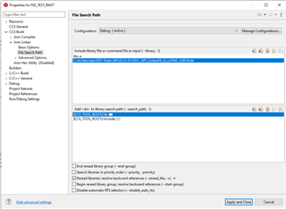

I am trying to work on a UART BOOTLOADER. The Example files provided for the UART BOOTLOADER is for RM48 microcontroller. I want to use for RM57L843 microcontroller. I have tried to migrate from RM48 project to RM57 project but I got several errors.
Then I have tried example provided for TMS570LC4357 microcontroller project. Here I have just created a New project with varient RM57l843 microcontroller with Empty project. Then I have pasted all the files provided in the TMS570LC4357 example project and i have included them into the project.
I got error in F021_API_CortexR4_BE_L2FMC.lib files Big endian to Little endian.
And got the following errors
gmake: *** [all] Error 2 UART BOOTLOADER C/C++ Problem
gmake[1]: *** [UART BOOTLOADER.out] Error 1 UART BOOTLOADER C/C++ Problem
How to clear those errors. How to migrate CCS projects. Is there any specific example for rm57 controllers for UART BOOTLOADER. If not what are procedure I need to follow.

  • Hi Ajith Kumar,
    Yes, there is a endianness difference between TMS570LC4357 and RM57.
    TMS570LC4357 - Big Endian
    RM57L84x - Little Endian
    So, we should not use same flash library for both the controllers.
    You should select "F021_API_CortexR4_LE_L2FMC_V3D16.lib" flash library for RM57 controller:
    And remember that is not enough, you should also make sure the "type castings" while we are converting BE code into the LE.
