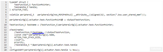

    In any case, I've narrowed the problem down. It seems to be an issue with the task schedular and the way I'm using xTaskCreate. For the first argument of type TaskFunction_t I'm trying to pass a variable of type TaskFunction_t that I'm calling from shared memory.
    If I explicitly type the function name in place of the variable, or by using a normal variable in local memory, then there is no HwiP_prefetch_abort_handler crash. If I do use the shared memory variable but only load one core and allow the tasks to initialise before I try and load a second core, then there is also no problem. The problem only happens if I try and use a TaskFunction_t variable within xTaskCreate while booting multiple cores concurrently.
    This seems to imply that there's some sort of race condition, but nothing ever writes to this variable from any core after initialisation and I can use other variables from shared memory for other arguments of xTaskCreate just fine - it's only the TaskFunction_t that is a problem.
    If anyone can shed any light on this it would be greatly appreciated. Here are some snippets of the code:
    typedef struct {
        TaskFunction_t functionPointer;
        TaskHandle_t handle;
    } ACTUATOR_TASK;
    volatile peripheral_t   peripheralcfg[MAX_PERIPHERALS] __attribute__((aligned(32), section(".bss.user_shared_mem")));
    peripheralcfg[i].actuator.task.functionPointer = vOutputTaskFunction;
    TaskFunction_t taskName = (TaskFunction_t)peripheralcfg[i].actuator.task.functionPointer;
    xTaskCreate(
        (TaskFunction_t)taskName, //vOutputTaskFunction,
        (const char*)peripheralcfg[i].name,
        ACTION_TASK_STACK_SIZE,
        (void*)i,
        priority,
        (TaskHandle_t *)&peripheralcfg[i].actuator.task.handle
    configASSERT(peripheralcfg[i].actuator.task.handle != NULL);

  • Thanks for your input Ashwin.
    Is the shared memory marked as Non-cached in MPU for all cores?
    Yes.
    Also, can you try to check the value of taskName variable in CCS for each core ?
    I have and it's exactly as expected. The task even appears in ROV, but it crashes the core when it tries to initialize - I now assume because the task isn't correctly pointing to the intended function code.

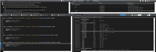

  • Hi Tron,
    Can you check the highlighted variable when all cores are running concurrently? This might help to understand if other cores are somehow corrupting the function pointer variable.
    Ashwin
