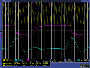

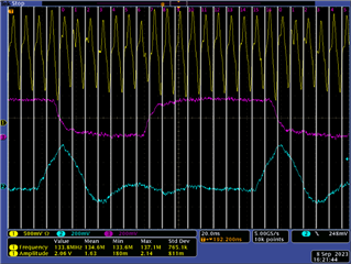

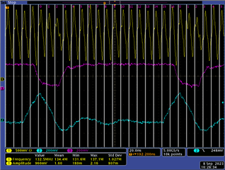

  • Hi Manasori,
    Below results show that the transition from address to data occurs on the GPMC_FCLK clock cycle set in bit field WRDATAONADMUXBUS.
    The transition does not occur 1 GPMC_FCLK cycle after the GPMC_FCLK edge specified by WRDATAONADMUXBUS as indicated by the datasheet.
    Instead GPMC_FCLK is the reference point, and the signal becomes active on the bus at the specified GPMC_FCLK cycle defined by WRDATAONADMUXBUS -2.3ns to +2.7ns.
    Since GPMC_FCLK cannot be observed directly, you can instead observe GPMC0_CLK with GPMCFCLKDIVIDER = 0 (div-by-1).
    For reference, the address is driven at GPMC_FCLK cycle 0 and the Chip select is driven low at GPMC_FCLK cycle 1.
    WRDATAONADMUXBUS is swept from 7 to 0 in below scope shots
    CH1 (yellow) = GPMC0_CLK
    CH2 (cyan) = GPMC0_CS0n
    CH3 (magenta) = GPMC0_AD12 (every bit on the AD bus transfers from address 0 to data (all F's)
    WRDATAONADMUXBUS = 7

    WRDATAONADMUXBUS = 6
    GPMC_CONFIG1_0    0x28001200
    GPMC_CONFIG2_0    0x00101C01
    GPMC_CONFIG3_0    0x23060917
    GPMC_CONFIG4_0    0x1005BC1A
    GPMC_CONFIG5_0    0x011B111E
    GPMC_CONFIG6_0    0x8F060000
    GPMC_CONFIG7_0    0x00000C50
    WRDATAONADMUXBUS = 5
    GPMC_CONFIG6_0    0x8F050000
