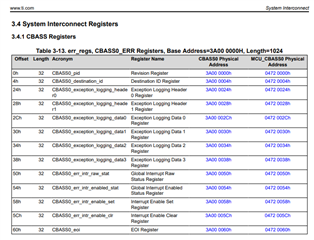

2. Firewall exception registers
The chapter 3.3.2.1 in [A] mentions multiple bits in multiple registers:
- CBASS_EXCEPTION_LOGGING_CONTROL[0]:DISABLE_F
- CBASS_EXCEPTION_LOGGING_CONTROL[1] DISABLE_PEND
- CBASS_EXCEPTION_PEND_SET[0] PEND_SET
- CBASS_EXCEPTION_PEND_CLEAR[0] PEND_CLR
I could not find any reference in the subchapters under 3.4 System Interconnect Registers and the exact naming is never mentioned again in [A].
Question: Where can I find these registers? Are they under DMSC control?
3. CBASS Registers vs. CBASS_FW Registers
Chapter 3.4 System Interconnect Registers in document [A] contains subchapters called CBASS Registers and CBASS_FW Registers.
When reading the CBASS0_pid register from 0x3A000000 it returns plausible values. When reading CBASS_FW0_pid then 0 is returned
Question: To which of these collection of registers does the firewall functional description refer to? Which one shall be used for error handling?
Question: When provoking a Firewall exception by reading from firewalled memory - the CBASS_EXCEPTION_LOGGING registers all remain 0x0 when reading from DataAbort Handler. How can I retrieve the exception info?
4. CBASS_EXCEPTION_LOGGING_DATA0
The description in [A] for this register is "Lower 32 address bits (31:0) of the incoming transaction"
Question: What exactly is meant here as "incoming transaction"? Does this field correlate to the DFAR value when in DataAbort mode?

  • Hello Simon,
    Here is information that was received regarding the missing registers in your query:
    EXCEPTION_LOGGING_CONTROL (Exception Logging Control Register).
    The Exception Logging Control Register controls the exception logging.
    Bit
    Name
    Type
    Reset
    Description
    31:2
    reserved
    r
    0x0
    Reserved
    1
    disable_intr
    rw
    0x0
    Disables logging interrupt when set. This will not disable logging, so if cleared the current log should also be cleared to guarantee the next log generates the interrupt.
    0
    disable_f
    rw
    0x0
    Disables logging when set. This will also disable interrupts.
    EXCEPTION_PEND_SET (Exception Logging Interrupt Pending Set Register).
    The Exception Logging Interrupt Pending Set Register allows to set the pend signal.
    Bit
    Name
    Type
    Reset
    Description
    31:1
    reserved
    r
    0x0
    Reserved
    0
    pend_set
    rw1ts
    0x0
    Write a 1 to set the exception pend signal.
    EXCEPTION_PEND_CLEAR (Exception Logging Interrupt Pending Clear Register).
    The Exception Logging Interrupt Pending Clear Register allows to clear the pend signal.
    Bit
    Name
    Type
    Reset
    Description
    31:1
    reserved
    r
    0x0
    Reserved
    0
    pend_clr
    rw1tc
    0x0
    Write a 1 to clear the exception pend signal.
    • see the _err_intr in the link below
    • See the Default_exp in the link below
    • The incoming transaction here refers to the transaction that violates the firewall protection.
    5. CBASS0_EXCEPTION_LOGGING registers contain data when halting on breakpoint entering main()
    After power cycling the TMDS243EVM and running a debug session on R5F_0_0 I halt execution on entering main() for ~20 seconds.
    I could observe from the Memory Browser that the exception logging registers starting at 0x3A000000 get updated with seemingly plausible data.
    For example the CBASS_EXCEPTION_LOGGING_DATA0 contains 0x39FFFFAC - an address which is observable concurrently in the Memory Browser.
    Question: What could be causing this exception given that I am looking at the correct registers?
    • The details of the transaction that violates the firewall and the source of the transaction can be found in the details of the Table 1 in the link below
    /cfs-file/__key/communityserver-discussions-components-files/908/Interrupt-Condition-for-Interconnect.pdf
